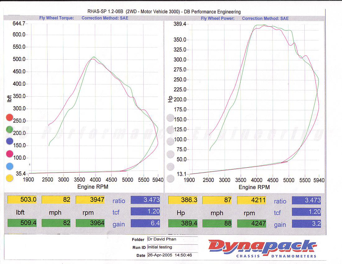

    Here is a dyno result
    http://www.lextreme.com/dyno/LS400hp.jpg
    http://www.lextreme.com/dyno/LS400psi.jpg
    Those are only flywheel #s. The car was running very rich and it was later found out that it probably had 3 bad pistons. It was also not tuned. After finding a loss in compression in a cylinder or two, probably due to the copper head gaskets, the motor was pulled out of the car. It is currently being overhauled and stuffed with forged internals.
