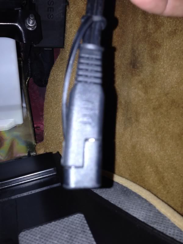

    So on my F430, it came with an OEM battery tender. There is an extension line coming out of the battery terminals where I would think the unit would simply plug into. I've used battery tenders before. However, the unit does not fit into the socket. It seems as if that extension was made for another tender. I've looked at it many times and it's just not compatible. I'll post a pic of it tomorrow.
    Now the unit does have extensions for alligator clips. I guess I can use that. My question is, can I simply attach the clips to the correct terminals/bolt or is there an easy "shortcut" location I can install the clips to the + and - terminals? I know it is more of a hassle since I need to take the footrest door all the time but until I can find the correct socket, it will have to do.

    Mine came with two pigtails -- one direct to the battery with crocodile clips and one to the terminals behind the drivers seat bolted on. I was not too happy leaving the crocodile clips so I pulled that off. I would only use bolted connections but that's just me.

    Th eF430 has a special socket in the passenger footwell specifically for a tender -- the nice thing about using this socket is that it illuminates the "Battery Tender Connected" icon on the instrument cluster and prevents the engine from starting while the tender is connected (this avoids the embarrassing "backing down your driveway while trailing a battery tender" game :)) - it also makes plugging and unplugging the tender easy.
    I detail how to build the cable here: https://www.ferrarichat.com/forum/141102598-post12.html
    Basically you snip off the alligator clip and crimp on another connector and you are done...

    I have that as well too. However, the end of the battery tender does not have the plug to connect to that. It only has alligator clips.

    Great! So hopeful the way I'm doing it with the alligator clip works.
    However, since it seems I do have that plug connected to the battery, I wonder if I can simply find the correct attachment to replace the alligator clips and simply plug/play. Basically, I need the right cable at this attachment below that will plug directly into that socket. I wonder if that is the correct one on the last pic???

    THANKS FOR THAT! Now I see it. I'm missing two cables on the pic ... the simple connector ones.
    I guess the cable I have hanging out is from a different type of BT.

    You need this adapter, it will allow you to use a off the shelf CTEK maintainer, SAE to CTEK , they sell it on amazon , eBay. Much cheaper option.
    The BT you're showing is the original Ferrari CTEK which came with the later MY 430s. Your car is not wired for that maintainer.

    Are you speaking of this:
    Ctek Comfort Indicator w SAE Pigtail US 800 3300 7002 Adapts to Battery Tender | eBay
    So this connects to the current wire from my battery or will this connect to the battery tender? To get rid of the alligator clips, is there another attachment/wire that plugs to the batter tender?
