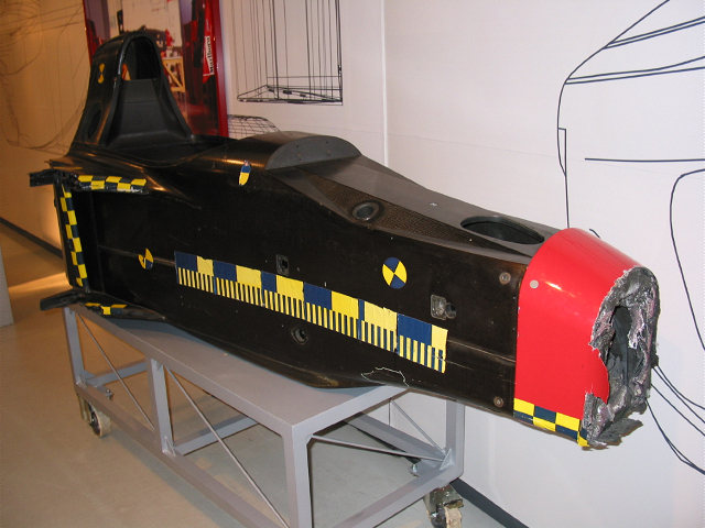

    what do you all think of the failure of the monocoque.
    Moderator, don't shoot me, but I was so intrigued by this shot on page 9 of the Monterey thread, that I thought I'd show the F1 hounds here.
    Is this at all what you would expect a carbon fiber monocoque faioure to look like? This crash allegedly occurred on a low speed parade lap of Ferrari F1 cars at Laguna Seca yesterday.

    I'm not an expert on carbon fiber monocoques, but I would say there is about a zero percent chance that this could happen to a real Ferrari F1 car, unless someone grafted on a fiberglass nose. No way. It must have been a "display" chassis, or some other explanation.

    It IS broken like glass would fail, good point there. I think there is an assembly joint at this bulkhead, however...don't they split to this point to adjust shocks and suspension???

    I looked again, never mind...MUCh further back that front nose/cockpit splice..but you can see a mounting flange of some sort in the photo as if this is an assembly joint in the car.....

    It seems that Kroyman's F399 is chassis #193, which happens to be the same car that Michael Schumacher crashed into the barriers at the British Grand Prix in 1999, breaking his leg. According to Autosport, "There is concern over the monocoque breaking at just 66.5 MPH" (his impact speed with the tire wall). So - we know that car had a cracked monocoque. Who repaired it, was it properly repaired, did Ferrari give the car their OK to compete again?

    No way this was a true F1 car to FIA regulations. They just don't break like this. The speed given is close to the FIA crash tests, you wouldn't get their approval if something like this would ever happen.
    *IF* this is a real car and not a display car as some mentioned, then it had issues, like a cracked monocoque. F1 cars don't brake like this at these speeds, not even at much higher speeds.

    Looked further into the Autosport reports from 1999 races, and they indicate that chassis #193 was used by the Ferrari team at races later in the year, after the British GP crash. So I guess the factory repaired it, if the chassis number information is correct. But it NEVER, EVER should have broken like Kroyman's car did. Something funny there.

    I hope the factory fixed it after Silverstone in a way that such a break could not have happened. If they didn't, which is possible, after all once a F1 car has been approved by FIA, there are no more further crash tests, then they would have seriously gambled with the drivers' lifes. Hard to imagine. So I'm sticking to my speculation: Shoddy repair work after it ended its official racing career at the S/F.

    Found this
    http://www.barchetta.cc/All.Ferraris/images/0400/img-0124-1.jpg,
    don’t know what year, or for sure that it’s a Ferrari, but it came from a Ferrari site.
    As you can see, there is no bulkhead or mating joint.
    My guess is that somehow Kroyman”s is a repaired tub that the factory never intended to race again.
    The break is too clean to be a one piece lay-up although there might be a Titanium bulkhead bonded into the carbon fiber tub and that’s where it failed.
    I would like to know much more about just what happened.
    Is it possible the structure failed a caused the crash? I would like to see a video of the incident before making any calls.

    It's far too clean a break for there not to have been a joint there. When carbon fiber fails there is always some zig-zag edges, since some of the fibers will be at 45 degrees to either vertical or horizontal.
    I think the entire nose may have been replaced after the Schumacher crash. They simply cut the entire nose off and grafted (or fastened?) on a new one. If this was done while the team was still using it that might have made the car illegal. At any rate, they should have declared it "not to be driven" after its retirement from active use.

    I think that's the most likely explanation. This is so bad that I think we really need an official statement from Ferrari or the owner of the car to clarify exactly what went wrong. If I was an owner of another Ferrari Clienti F1 car, this is the type of thing that would make me very very nervous!

    In these photos is almost looks like some sort of adhesive was used to bond the nose to the remainder of the chassis. Look at the thin white line around the circumference of the joining rims. It appears that nothing actually broke, other than this joining point; something like this would have to be incredibly dangerous!
