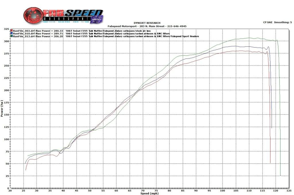

    I had a customer drop off his 97 F355 5.2 injection car last week to let us do some dyno testing on our carbon fiber covers and Fabspeed headers. I am installing the headers as we speak and will have some info up for you guys in the next couple of days with video, pics and dyno graphs!
    Hang tight : )

    Wouldn't it make more sense to do a before / after test with just the airboxes on a stock car? I'm sure there are a lot of people interested in the airboxes that have no plans on upgrading the headers.
    What are the before numbers?

    The F355 that we have here is not stock. Car already has Tubi Muffler, Fabspeed Cat-bypass and secondary cat-bypass. I dynoed the car as it sat with the components I just listed to get a baseline. I then installed the Fabspeed carbon airbox covers and re-dynoed the car. The next step is to dyno the car with the Fabspeed Headers.
    Here is a dyno of the Fabspeed Carbon airbox covers

    Really helps (9+ hp) above the speed limit! :D Keep 'em coming!

    Nice gains on the airbox! We got 17rwhp on our headers that have been discontinued on a dynojet (311rwhp - 328rwhp).
    Look forward to seeing your gains.

    One suggestion - change the chart to show rpm across the bottom line versus speed, add torque to the right side.

    As far as the dyno graph.... Our RPM pickup leade is not working properly and I cannot hold a steady tach signal past 4K rpm. I can only show the hp over speed unfortunately.

    Ok guys...this is what you have all been waiting for!!! I finally got the 355 back together late today and was able to strap it down on the dyno and make a couple pulls. tomorrow I will have more pictures and video for you, but I wanted to at least get the dyno graph up for everyone tonight. The headers lost a little bit of midrange power but really opens things up from 5k all the way to redline. I took the car out on the street and went for a nice ride and did not notice the slight loss a mid rpm, but could really feel the change in power all the way till redline.
